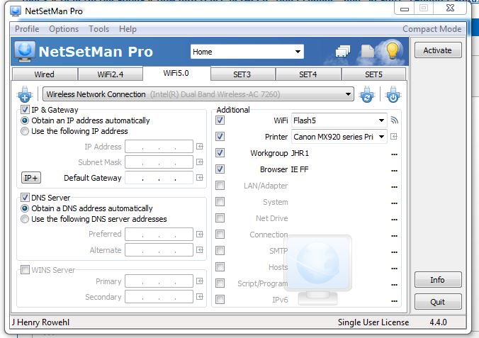

What settings are you changing in this profile? There are settings that require the NIC to be reinitialized (which is like restarting it). So if you for example are changing the IP address of your WiFi NIC then you'll automatically lose the connection for a short moment.
Here's a screenshot of the 5Ghz profile:
IP and DNS are obtained automatically, I'm not assigning them as part of the profile. Wild guess - changing the workgroup is the source of the adapter changing state?
As far as getting on the other AP (I had the wrong ones referenced in my original message...), I can't say for sure. It might be that the signal is not below the threshold, and Windows and/or Proset doesn't see a need to shift to the closer AP. This is way outside my area of expertise, so, consider that as a wild guess too. :-)
Setting the IP configuration to DHCP is the same process as assigning an IP address manually. So in your case the NIC is briefly disconnected after the IP settings have been applied.
