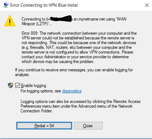

Hello,
I want to replace windows VPN disorder with NetSetMan.
1. I tested many VPN connections with L2TP/PSK and about 25% of them not working from profile - connection from NetSetMan, the connection show in windows VPN manager "connecting" and after a minute i receive attached error. When i press recconect is connectign in 1 second. I made an research and it seems to be from used passwords, don't work very good when i have passwords with !, # or @ or other special characters. In other side, at the VPN Server (mikrotik router) i receive error that tell me the used user is the Windows user, NOT the user stored in Windows VPN manager. After i change user password or preshared key or both, connections start working from NetSetMan. These connection is working before changing passwords from windows VPN manager. What kind of file or report shoud i send to you to see what is happen? I tested in Windows 10 and two windows 11.
2. In connection - disconnect all conections if i make a profile with this selected to disconnect connected VPN is not working, i want to use this profile to disconect from any connected VPN or to use somenthing to disconect from connected VPN
3. In tray info is not show the connected VPN connection
https://www.netsetman.com/support/img/m … -error.jpg
Thank You!

#2 2022-03-19 13:37
Posts: 1,916
Re: Problems regarding VPN connect/disconect
NetSetMan is not a VPN client. It simply acts as a shortcut for triggering existing VPN connections on your system. Everything you have written now is a problem you will need to solve with your VPN connection. As soon as it works on its own, you can try integrating it into a NetSetMan profile. It doesn't make sense to search for a solution in NetSetMan if the actual VPN connection isn't working.
I know all that things. The connection is working from Windows, but when i trigger existing VPN connection from NetSetMan i get errors that i described. Is strange, i know... All connection is working from Windows but when i trigger from NetSetMan i get errors at few of them...
I managed to connect from NetSetMan to VPN connections that not worked after i changed passwords and change them back (twice change!).
