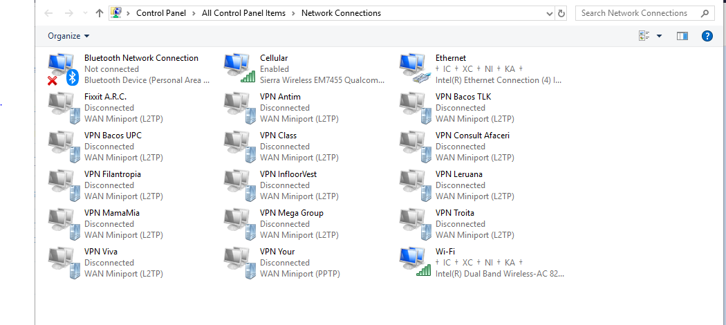

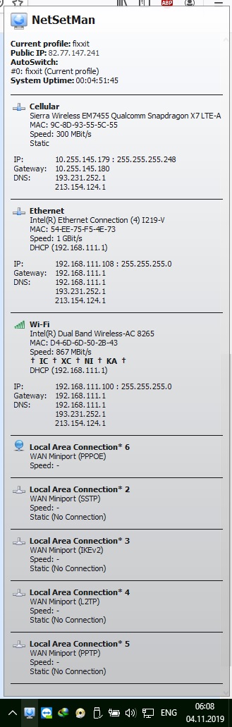

In tray info is not showing VPN connectiun (L2TP) even if i'm connected. I try with diffrent connections.
I try to exit/restart the program, the same result.
And as suggestion: is some way to manage the VPN connections within NetSetMan? And run VPN connections from tray menu? Is very annoing Windows 10 menus...

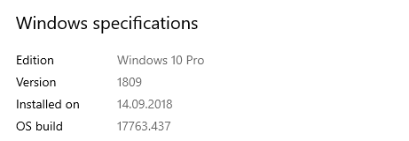

I have uploaded printscreen from connections, trayinfo and Windows version.

The TrayInfo displays the adapters that are in your network adapters list. You can manage this as described here:
https://www.netsetman.com/help?hf=en#hf_nics
This should also help you removing network adapters that you don't need there (like all your "Local Area Connection *" adapters).

But problem still remain, in Manage network connections my VPN-s are not showing and for that i cannot see them in the tray info. I push refresh, i try every setting from Preferences-tray menu and tray nothing. None of VPN's conected or not.

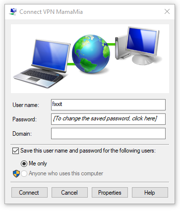

To conect to VPN from profile an window is poping up to push connect every time... can we make this without this comfirmation (i attach the print screen). Could be very useful an Utility VPN separatly from profiles that to conect to a VPN with a single click with no comfirmation. Now i must to make an profile for every VPN, to push activate and push connect, is the same effort (three clicks of mouse) like from windows interface. Now windows menu is huge and must to scroll to ghet the connection that i want. May be you make somthing like that in next release.

If the VPN connections are not in the Connections list, then go to NetSetMan > Preferences > Tray Info and check Connections (if that doesn't work, try checking Virtual adapters as well). Now see if your VPN connection shows up in the Tray Info. Notice, that it needs to be connected for that.
Regarding your other request not to see the Connect dialog: You don't need an extra tool for that.
Click on the Properties button (as seen in your screenshot), switch to the Options tab and uncheck "Prompt for name and password, certificate, etc.". That's all.

The point 2 was solved partially, now i can connect without promt thank to last post from here:
https://www.tenforums.com/network-shari … ialup.html
but for disconnect from VPN i must to make another profile that in connection i must to set disconnect all connections.

Make sure the VPN connection is available for all users, not just a specific one. If you have also set Preferences > Tray Info > [x] Connections (PPP, VPN, ...) then it should be shown in the TrayInfo when it is connected.
