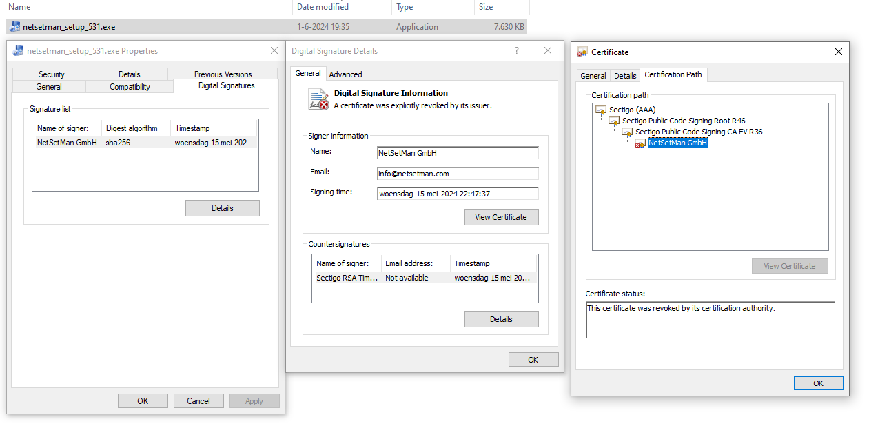

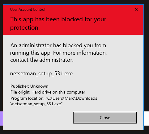

Hi
Attached the images you requested.
Run as Admin would not work in (most) machines because of UAP policies.
I think that is the reason why im getting this message.

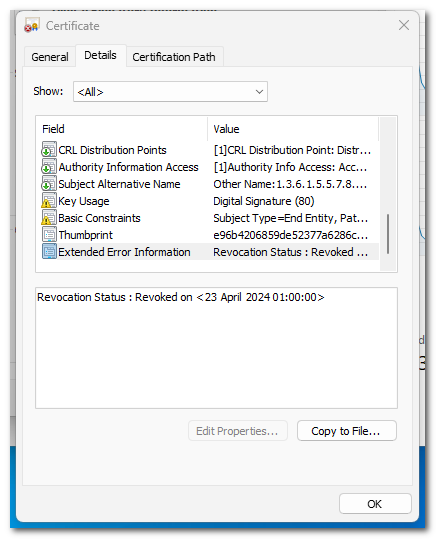

Revoked on 23 April 2024 01:00:00
