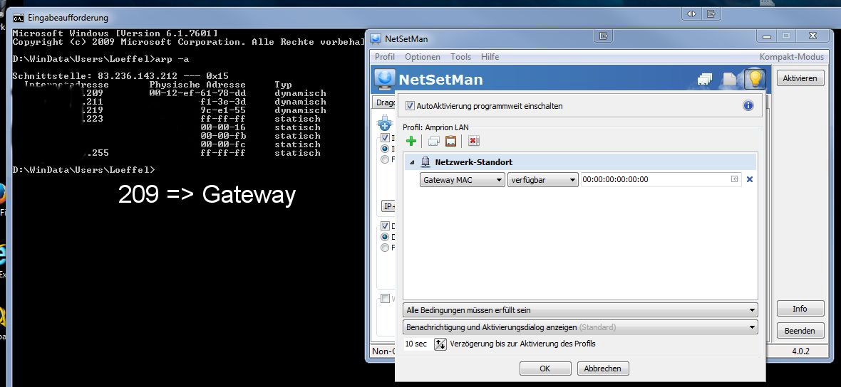

the autoswitch via the MAC-Address of the gateway isn't working. It seems the NetSetMan isn't able to identify the MAC-Address of the gateway. When I enter the settings, I must enter the MAC manually as the read out button for the actual gateway just brings up 00:00:00:00:00:00
If I read out the arp cache (via arp -a) the MAC-Address is correctly shown, so she is available for the system but not for NetSetMan.

I just checked the Output of the tool you send me.
Just to understand it correctly. You use the MAC-Address of the DHCP Server for the autoselect of the profile?
That isn't a proper way and will fail often. Why?
If the DHCP-Server is in another subnet as the client you aren't able to discover the MAC-Address of the DHCP-Server as such informations are only available in the local subnet. To identify the network the only possible and logical way is to use the MAC-Address of the default gateway. As you can never be sure that the DHCP-Server is in the same subnet as the client.
