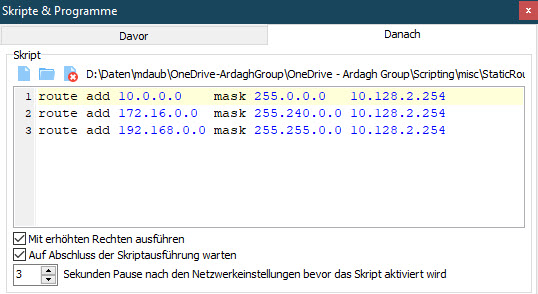

[0:16] Skript (Danach): Start
           StaticRoutesBonn.cmd
[0:16] Skript (Danach): Warte
[0:16] Skript (Danach): OK
[0:17] Ende (08:18:57)

With script execution Routes are added successfully.
#9 2021-03-23 08:27
-JustMe-
Registered: 2017-02-14
Posts: 10
Re: Routing Tables are not applied
Image from script added

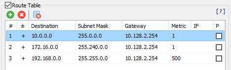

#10 2021-03-25 19:56
We tried to reproduce your the described problem with the exact same route table settings, but "unfortunately" it worked as expected.
Here's the starting point on one of our test systems:
IPv4 Route Table
Active Routes:
Network Destination        Netmask          Gateway       Interface  Metric
          0.0.0.0          0.0.0.0    192.168.199.2  192.168.199.131     25
        127.0.0.0        255.0.0.0         On-link         127.0.0.1    331
        127.0.0.1  255.255.255.255         On-link         127.0.0.1    331
  127.255.255.255  255.255.255.255         On-link         127.0.0.1    331
      169.254.0.0      255.255.0.0         On-link     169.254.136.0    276
    169.254.136.0  255.255.255.255         On-link     169.254.136.0    276
  169.254.255.255  255.255.255.255         On-link     169.254.136.0    276
    192.168.199.0    255.255.255.0         On-link   192.168.199.131    281
  192.168.199.131  255.255.255.255         On-link   192.168.199.131    281
  192.168.199.255  255.255.255.255         On-link   192.168.199.131    281
        224.0.0.0        240.0.0.0         On-link         127.0.0.1    331
        224.0.0.0        240.0.0.0         On-link   192.168.199.131    281
        224.0.0.0        240.0.0.0         On-link     169.254.136.0    276
  255.255.255.255  255.255.255.255         On-link         127.0.0.1    331
  255.255.255.255  255.255.255.255         On-link   192.168.199.131    281
  255.255.255.255  255.255.255.255         On-link     169.254.136.0    276
Based on your logs, we configured these settings:
This is the activation log:
[0:00] Route Table: Start
           + 10.0.0.0 255.0.0.0 10.128.2.254/1
           + 172.16.0.0 255.240.0.0 10.128.2.254/1
           + 192.168.0.0 255.255.0.0 10.128.2.254/500
[0:00] route add 10.0.0.0 mask 255.0.0.0 10.128.2.254 metric 1
[0:00] OK!
[0:00] route add 172.16.0.0 mask 255.240.0.0 10.128.2.254 metric 1
[0:00] OK!
[0:00] route add 192.168.0.0 mask 255.255.0.0 10.128.2.254 metric 500
[0:01] OK!
[0:01] Route Table: OK
This is the result. Notice the added lines 2, 9 and 10:

We also would like to point out one thing:
For the routing functionality, we are not using any special API, but simply the command lines that are displayed in the activation log:
"route add 10.0.0.0 mask 255.0.0.0 10.128.2.254 metric 1"
And the next line is streamed from the command line result directly into the activation log:
"OK!"
If there as a problem with that command, there would be some error instead of "OK!".
In your activation log we can see the "OK!" results as well, so they must be successful.
As far as we know, the routing table is the same for all users, so there cannot be any account mixup either.
We are simply out of ideas why this might be failing in your case.
Could you please create a detailed screencapture video showing the whole process from start to finish and where you check for the results? Maybe that way we will notice some important detail that is currently missing.
Also please try to break this problem down. Create a profile with just the Route settings without any other settings. See if this makes any difference. Maybe one of the following settings is resetting the configuration or something like this.
