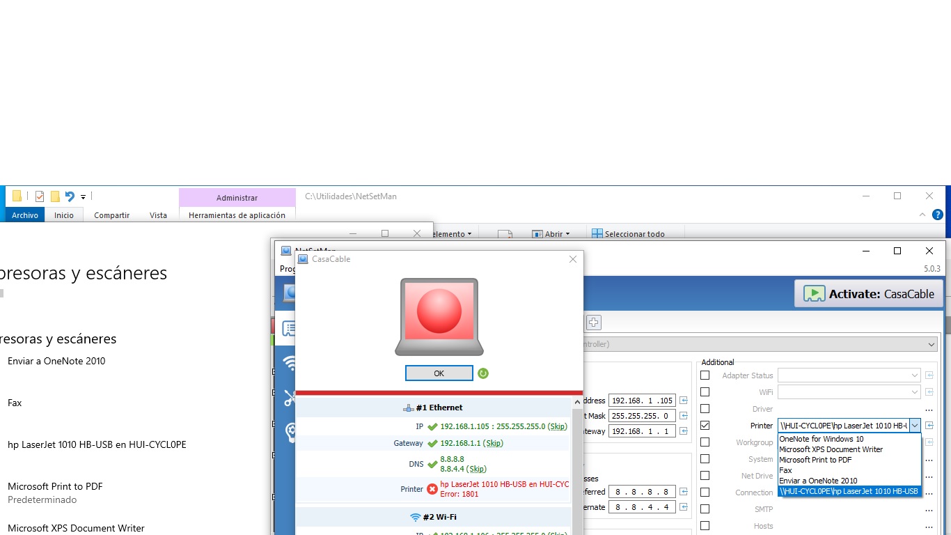

Printer "hp LaserJet 1010 HB-USB on HUI-CYCL0PE" appeared in the additional printer field.
When I pressed "Activate" I got error 1801 with the printer.
When I re-selected the dropdown menu, the printer appeared as "\\HUI-CYCL0PE\hp LaserJet 1010 HB-USB"

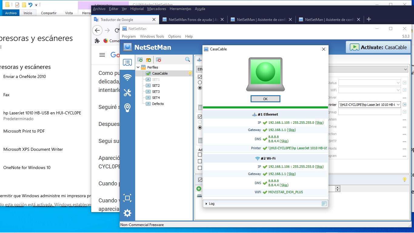

I selected it with this new name and, activated again, then the activation process was correct.
The new name also appeared changed in the netsetman.xml file
Thank you very much.
