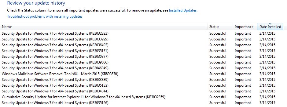

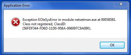

I have a problem where NSM has stopped working. I can not get ANY version of it to run anymore. I've tried reinstalling, NSM4 Pro, NSM 373 Pro, and the previous freeware versions. All are disabled.
Windows Update just installed 13 updates, and it appears that one of the updates killed NSM. I uploaded a screen capture of the update history, and a scfreen capture of the error message when NSM starts.

I got NSM 2 running, so at least I have something. I found that the unregistered class id, 56fdf344-fd6d-11d0-958a-006097c9a090, has something to do with taskbar comunications. any ideas on how to re-register that?

I got it fixed. I've been working with a malware removal group for a problem I've been having, and had made a registry backup less than 2 weeks ago. I restored the registry, and all is working again.

OK, let me see if I can make it work... First, the screen capture of the updates...
And the screen capture of the error...

To be honest I think this problem wasn't mainly the result of the Windows update but more of this:
Searching for this ClassID on the web a lot of pages come up where people report that they have this error (with other software) after having used some malware removal tool. Sometimes those tools remove more than they should.
