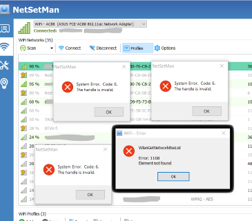

I've been using NetSetMan for almost a year without problems.  In the last 2 weeks I've been receiving an error when it tries to auto switch to a different WiFi AP.
"WlanGetNetworkBssList Error: 1168 Element not found"
The switching is unsuccessful and it then keeps trying to switch each time throwing the error.
If I don't dismiss the error windows they keep building up.  It then also presents an error:
"System error. Code: 6. The handle is invalid.
NetSetMan version: 5.0.5
Released: 2021-02-04
OS: Windows 10 (10.0.19042 Build 19042)
Network Adapter: ASUS PCE-AC88
WiFi: ASUS AIMesh network. Router: RT-AC86U, 1 x Node: RT-AC86U

Please describe in detail what you mean by "when it tries to auto switch to a different WiFi AP". The WiFi Management shown in your screenshot does not automatically switch to any wireless networks, so describe exactly the steps you are performing prior to this error.

This happens in the background without me having to do anything.  Recently however, I have been getting the errors described pop up on the screen and on investigation it was happening whenever NetSetMan was trying to switch from a connection that had deteriorated to one of the other 3 that were now a stronger signal.
The error effectively prevents the switching from the weaker signal to the stronger one.  It seems that NetSetMan has a polling frequency whereby it monitors the relative signal strengths on a regular basis. Therefore when the next check is done it again tries to switch only to encounter the same error again. The error messages accumulate if I don't dismiss them by pressing "OK".
Switching to the strongest signal manually in NetSetMan works perfectly.
It seems that NetSetMan uses the WlanGetNetworkBssList function to retrieve the basic service set entries of the wireless network(s) on the wireless interface.  The applicable error is:
ERROR_NOT_FOUND  :  The element was not found. This error is returned if the GUID of the interface to be queried that was specified in the pInterfaceGuid parameter could not be found.
This may indicate that the interface GUID on my PC and that issued by NetSetMan in the function call differ.
WlanGetNetworkBssList function (wlanapi.h)
I can recreate the error if, using NetSetMan, I manually switch to one of the connections that is significantly weaker.  NetSetMan then immediately tries to switch back to the stronger connection and issues the error.  It will keep issuing the error every 20 - 30 seconds each time it re-polls, until I manually switch it back to the strongest connection.
I have made a video of this behaviour and am happy to share it privately.

Based on your screenshot, you have more than one WiFi network adapter. Maybe this is somehow leading to this problem, because they get mixed up for some reason. Would you mind disabling one of them completely in the Windows Network Connections? Then restart NetSetMan and try again. Try narrowing it down as good as you can. Then we can start working on the issue based on your results.

I do indeed have 2 WiFi adapters: the original onboard one (AC-7600) and newer one (PC-88).  Although I left the AC-7600 physically installed I have had it disabled ever since I installed the PC-88.  I want it available in case I ever need to remove the PC-88 which has an external antenna.
i.e. The AC-7600 appeared as a network adapter, but disabled (greyed out).
NetSetMan does not seem to have worried about this until recently, but you are correct it is now trying to interact with the (disabled) adapter during auto switch events.
As a test I enable the AC-7600 and the error no longer occurred.  However, this threw up other problems and was not a workable solution.

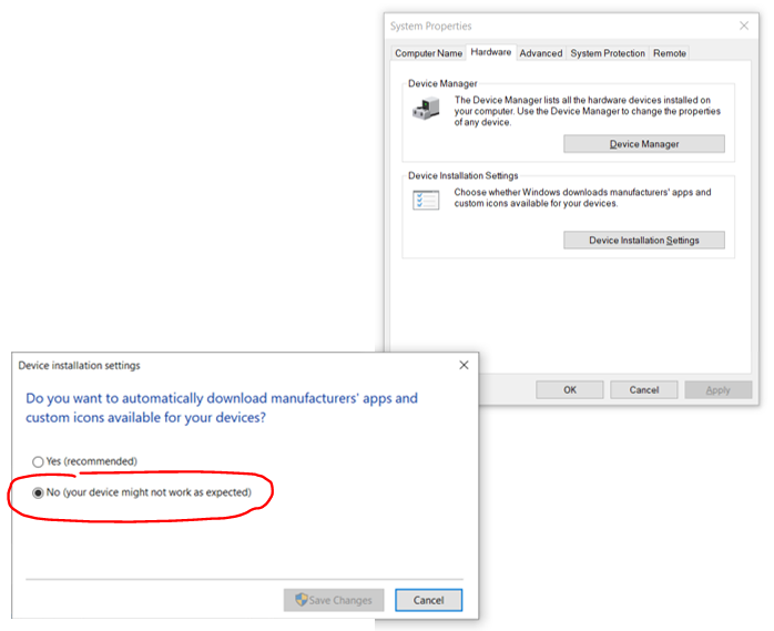

I tried uninstalling the adapter in Device Manager, but Windows just reinstalls it automatically.
Fortunately there is simple fix for that - disable automatic driver installation - as long as I remember to re-enable it temporarily when I need it.
The AC-7600 adapter no longer shows in Device Manager nor in Network Adapters. All seems to be ok now and after re-starting NetScanMan it also disappeared from there.  Auto Switch seems to working again without a problem.
