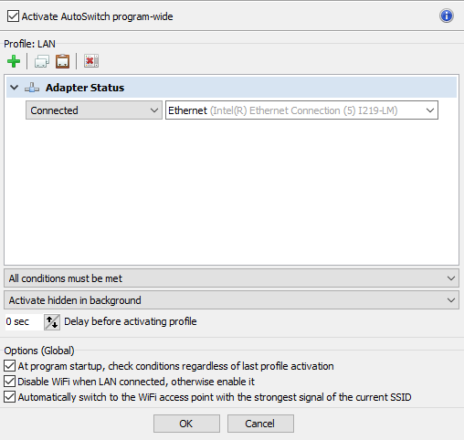

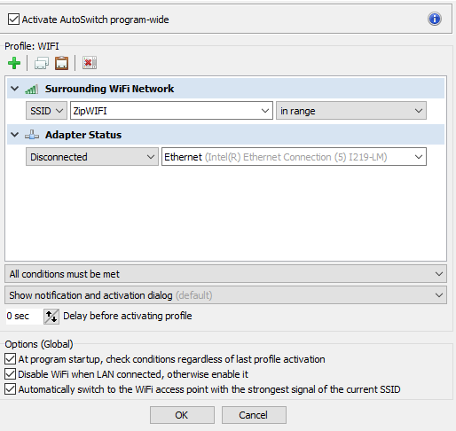

I built two profiles, one for LAN, and one for WIFI (both all DHCP) .
I setup autoswitcher enabled globally, switching timer to 0 seconds, and disable WIFI upon LAN connect.
I was testing this by disconnecting the LAN cable, and I get access violations.
The program does not switch reliably, usually is some extra delay 5-10 seconds, and sometimes i have to dbl click the tray icon and then it switches when it wakes up.
If I change auto-switch timer to 2-3 seconds, it seems to work more reliably. I just want it to switch fast/reliably without crashing.

Thanks for the reply. The main issue was the access violation / crashing which was causing the autoswitcher feature to stop working, and then needed to be manually stopped/restarted.
I'm using a real world scenario for testing. At desk, plug in LAN cable, and then removing LAN cable to go mobile. Nothing I see here is particularly unrealistic? Now, is 0 seconds for the GUI delay, and my settings all look normal? I just wanted this to happen as fast as it can, and i understand there are underlying system events that need to occur first.
I will try a beta ! If I can capture the access violation error again i will update with a screen shot. But even so i'm not sure that will help much.
