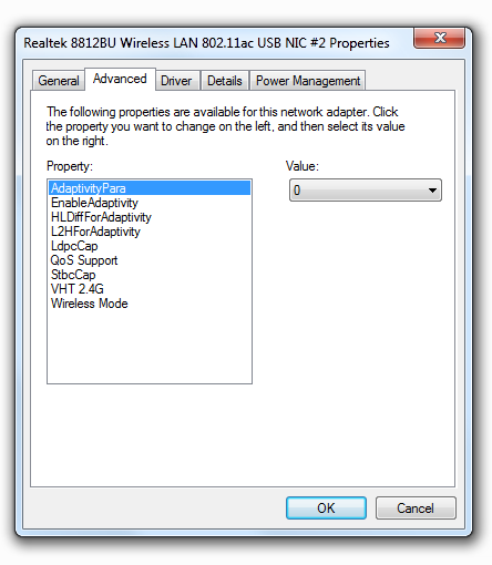

#4 2019-10-05 04:33
adlnetsetman
Registered: 2019-10-04
Re: command-line for 'In-Depth Refresh' or 'NSM WiFi Management'
Are you sure you looked in the right place?
Could you please include a screenshot with the available options for your wireless adapter?
To be on the safe side, I followed your instructions from here (I went via DeviceManager):
https://www.netsetman.com/support/viewt … 3795#p3795
PowerSwitch
I bought 2 x 5GHz USB last week, different antenna configs, but they both have identical device settings (I was hoping the antenna configs would help keep the connection stable - they do not). I have other USB wifi adaptors, but I can't find them right now - I'll let you know if they have those settings you mentioned ["Roaming Aggressiveness" (Intel), "Roaming Sensitivity" (Realtek)] & if it fixes my issue.
